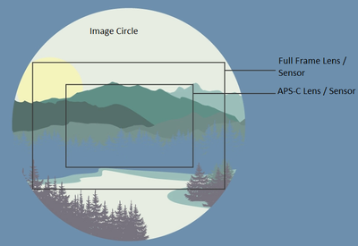

Here's the situation when moving from APS-C to full frame. The image circle of an APS-C lens is smaller and not capable of utilizing the entire size of a full frame sensor. You can't use APS-C lenses on a full frame DSLR. You can however, adapt APS-C lenses to newer full frame mirrorless body's ( a benefit) 😀. Full frame mirrorless bodys have a special crop mode (1.6x) which allows you to use lenses with the smaller image circle. There are some things you need to consider.
Since the image the APS-C lens projects does not utilize the full size of the sensor, the images which are captured are a lower resolution that what the camera's full resolution is. Here are some examples:
Resolution of body 24MP full frame sensor, If used with an APS-C lens, 9.3MP images are captured
Resolution of body 45MP full frame sensor, If used with an APS-C lens, 17.5MP images are captured
This might be fine if you plan to produce lower resolution images for social media and a smart phone. If you require higher resolution images, then using an APS-C (EF-S or RF-S) lens with a full frame mirrorless body might not be a good option.

I'm also including an image of what the camera sensor "sees" when you use a APS-C lens on a full frame body.
