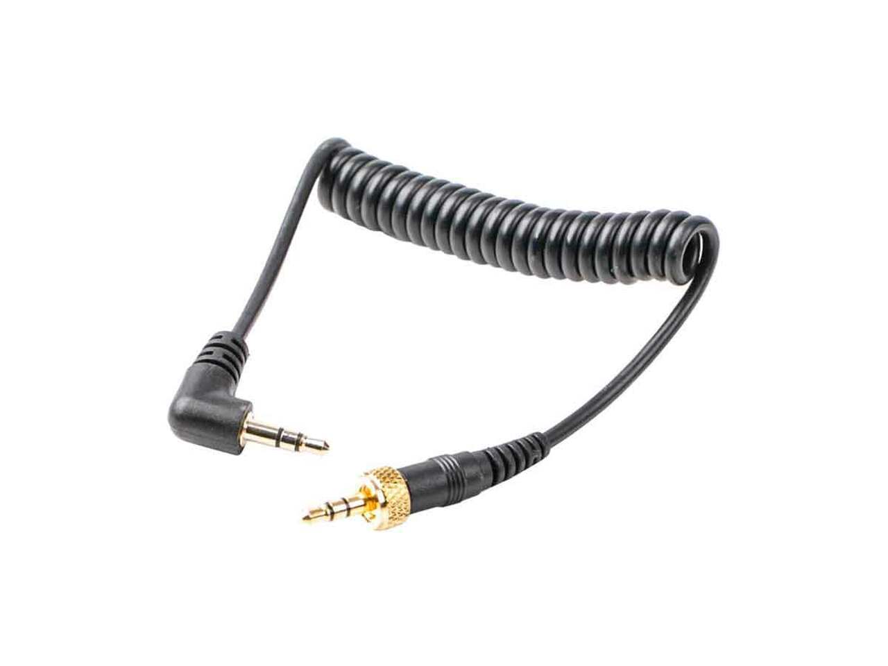

Hi RDJ
I have tested with the right cable from the lavalier reciver.
I have 2 TX and 1 RX from Saramonic.
I have tested the exact setup on a Canon 5D Mark II and I get independend audio on L+R (TX1 to L / TX2 to R)
I have tested the exact setup on my laptop and I get independend audio on L + R (just as the 5D)
I have tested the exact setup on my M50 and i get a mix-down of the both. If I speak on TX1, it gets recorded on L+R, the same when I speak in TX2.
Thank you
