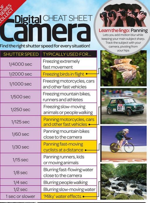

Tintype_18,
I ran across this shutter speed cheat sheet in the online version of Digital Camera magazine. I think it was in one of their December, 2021 issues. I've found it pretty helpful:
Steve Thomas
05-14-2022 10:00 AM - edited 05-14-2022 10:05 AM
Thanks for the chart. I'll copy and print it to add to some others I have for reference. I looked at the chart after printing. Slow moving objects sounds like some of my friends.
05-14-2022 02:36 PM
I would only use that chart as a starting point. Some of the SS are a bit questionable.
