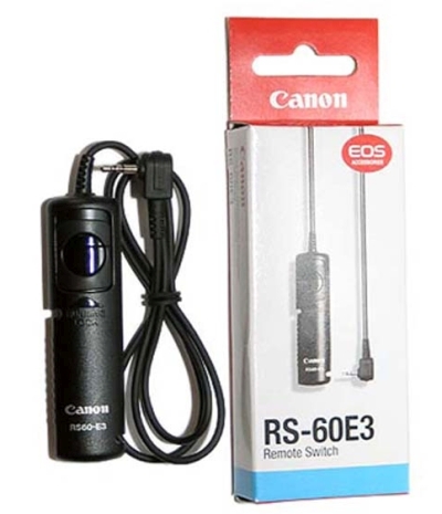

If you use a wired remote control like the Canon RS-60E, then you will be able to shoot continuous.

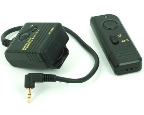

If you really need wireless, there are also some inexpensive 3rd party wireless remotes than can plug into the wired remote plug on the side of the camera.

It should work if you are using a wired remote such as the RS-60E3.

BTW, the reason this works with a "wired" remote is because of the simplicity of that jack that resembles a mini-stereo jack.
The on-camera shutter button has three positions... (1) not pressed, (2) half-pressed, and (3) fully-pressed.
The remote has the SAME 3 positions. One wire is the ground. One wire indicates the shutter is half-pressed. One wire indicates the button is fully-pressed. So there is literally no difference in what you can do with the on-camera shutter release vs. the remote shutter release.

Mike posted a 3rd party release that gives you the functionality of the wired (3-position shutter button) behavior... but with the advantage of being wireless if you are farther from the camera than the limited distance of a typical wired remote. The real point of the "wired" remote is to ensure that you can take a shot with a tripod-mounted camera without worrying that touching the camera to trigger the shutter will create vibrations that ruin the image.

I used to have the wired version with the remote, (similair to the second device photo in MikeSowsun's post, only it worked with my phone via blue tooth) but the tip broke off into my camera and it was a major hassel to remove it, so I've been a little put off by that type of remote device. But if it's the only way to do what I want I guess I'll look into getting another one.
