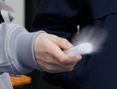

I've imported your file into Lightroom, and I do also see the lines. They seem to occur every 4px (I counted 10 lines in ~40px) and seem to be about 2 pixels tall. It shares some mild resemblance to something I noticed in one single photo on my R3. That looked like this:
In my case however, the bands were 12 rows 'tall' (wide in this image, because it was in portrait mode), and were only showing up in an area where there was a RAPID change of brightness in the scene from a CO2 'explosion'. In all previous and subsequent photos, I never saw anything like it.
In my case, they were bands caused by or related to the parallel readout of the sensor. I'm not sure if the R7 sensor readout works in bands of 2 pixels, but seeing this kind of artifact in stationary scenes with consistent lighting doesn't seem normal to me. There may be some electronics level issue with some of the parallel readout coming out darker than it should in bands of 2 compared to others, maybe the resistance being a bit too low or too high or something weird.
I honestly have no idea how those circuits work, I'm not an expert, but this definitely looks like it has to do with the parallel readout somehow, or possibly with the processing (Lightroom specific?) and seeing this kind of consistent deviation purely brightness level based, not movement based, with a non-flashing light source, is very weird to me.
