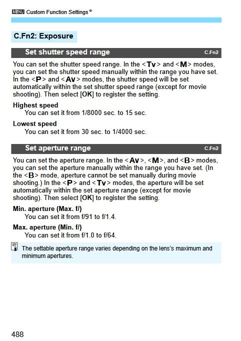

You don't want to reset the general camera settings, but the custom function:

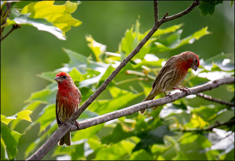

THIS IMAGE CAME OFF MY 5D Mk IV on an overcast day. I shot in manual, these were the settings: f6.3 @ 1/1000sec - ISO 1000

A regular factory reset doesn’t work for Custom Functions. Those must be cleared from the Custom Functions menu. Check page 481 of the manual to reset the camera’s Custom Functions. This will bring everything back to default EXCEPT CF 3. Is this camera new to you by any chance? EOS 5D Mark IV Manual
