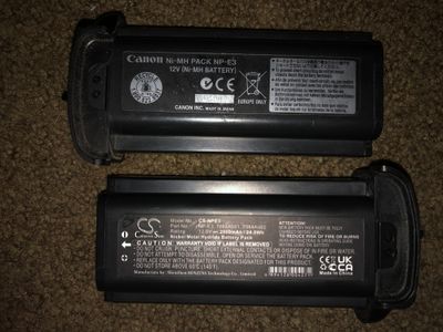

Hi, thanks for your response. I have two batteries both giving me the same result. I original canon and 1 newer third party battery. I can’t see this being the issue as the camera function fine until it tries to write to the memory card, i can’t imagine this is the most battery intensive stage. But I may be mistaken. The issue also happens occasionally in the warm.

Lithium-Ion battery or NiMH?
05-13-2024 02:55 AM
Both are NiMH

Hi Peter, i have refreshed the batteries twice. It took over 8 hours to discharge. I can use the batteries for 2-3 days shooting for 3 hours a day without an issue. So, the long discharge time and the long battery life I receive out of the camera hopefully indicate the batteries are in good health.
Unfortunately, refreshing the batteries did not solve my issue. The camera occasionally throws an error 99 but sometimes not. I do not believe it is an issue with lens communication as I have cleaned the contacts, the issue is still prevalent with manual lenses. I have tried rotating the manual lens on the mount so it is not “clicked in” to the ef lock as others online suggested. The issue even occurs without a lens. This has got me stumped, thanks for your help.
