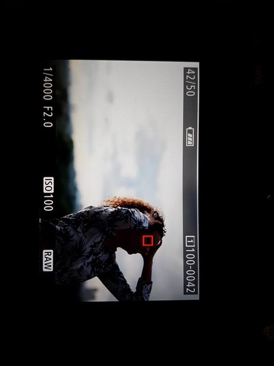

Hey,  thank you very much for your patience in explain me with so many details.
I got 2 examples when I have faled with focus some minutes ago:
I the first you can see the image with no focus on face and the second shows were was the focus point when I shoot
As you can see, the focus is on the elbow, and far from the face where I had originally fixed. Yes Im using beep and in that case I purposely used the extreme aperture to perform this test
 7D MarkII + 50mm 1.4 in 2.0

The most likely explanation is that the face is too dark to focus on. Use a speedlite with autofocus assist beam. If you actually want the face to be dark, turn off the main flash, but leave the AF assist beam active.
Bob
One, focus points are a little bigger than the squares you see represented in the viewfinder.  If you were using One Shot mode, your subject's elbow may have moved been within the AF point.  Remember, the focus point displays can show you where in the frame the camera locked focus, but not necessarily when it locked focus on a moving subject.
http://www.dofmaster.com/doftable.html
I also suspect that this sample shot could also be an issue with Depth Of Field.  How far away was the subject?
