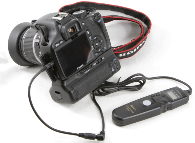

If you want a timer, it would probably be easier to get a 3rd party release. There are third parties which make remote releases with intervalometer function (timers) for Canon cameras that already have the correct sub-mini jack.
If you want the Canon brand, the Canon "wired" release which has a timer/intervalometer is the RS-80N3 -- but there's a catch. The Canon intervalometer is intended for use on their higher end cameras and the connection is physically different -- it uses a Canon "N-type" connector. Canon makes an adapter (because these are all 3-conductor wires -- one wire is the ground, one wire signifies a "half press" of the shutter, and the final wire signifies the "full press" of the shutter.) But the "catch" is that they don't sell the adapter as an accessory... it's sold as a replacement part for the Canon 60Da astrophotography camera (astrophotographers make very heavy use of intervalometers -- it was essential that they provide a way to make this work).
The Canon RA-E3 adapts the Canon "N-type" connector of the RS-80N3 to the sub-mini jack (looks like a small stereo headphone jack) that the camera needs. You will not be able to find the RA-E3 sold as a part anywhere (if you do... please let us all know where you found it.) As far as I'm aware, the only way to get this adapter is to phone Canon and ask to order it as a replacement part.

There are 3rd party versions of the Canon RA-E3 available:
Amazon.com: DSLRKIT Remote Terminal Convert Cable
Ebay: N3F-E3M
