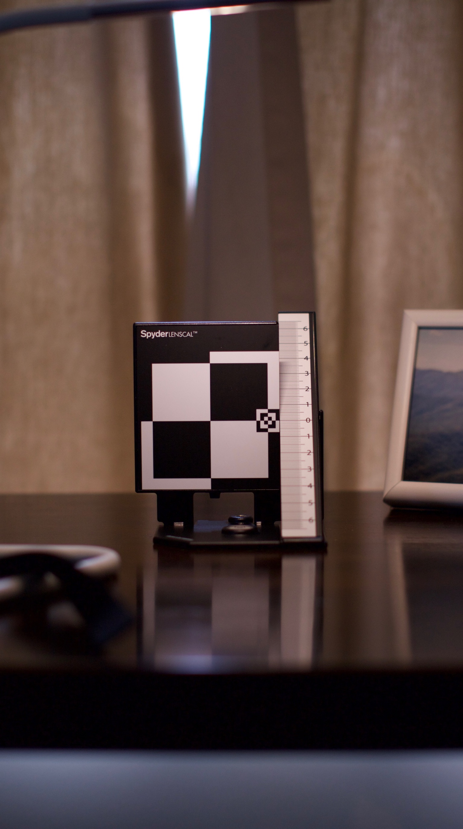

I just recently bought a new 50mm 1.2. On my 6d I was able to get good focus after micro adjustment at -10. On my canon 5d mark 3 it’s still seems to be off at -20 and is not as sharp as the 6d. I used the spyder lens cal and a tripod make sure I am 25*50mm back (about 50inches) I also shot wide open at 1.2.

So ya on my 5d it’s way worse.
The picture below is at 0 microadjustment
0 focus adjustment

I haven’t really tried manual yet. I know DOF very low but I just feel like it’s not as sharp or on point with it’s autofocus as it should be. ( I know it’s not the sharpest lens either) thank you for your reply!
Are you testing wide open at f/1.2 for the shallowest possible DOF?  There's an oddly large amount of the scale in focus in the second photo.  Nearly the whole ruler.
Could be a fluke of the curved focal plane working in accidental combo with the out of whack focus, on the slanted scale, I suppose.

Making AFMA adjustments should be done with care.  It is much easier to make bad adjustments than correct ones.
I perform adjustments at 50x the focal length, and at minimum aperture.  You should use lighting that is similar to the conditions that you expect to encounter when you use the lens.  I am certain that bright streak of light, which appears to be coming from a window curtain is not helping matters.
If you have any filters on the lens, you should remove them for the AFMA testing.
You should take several test shots and average the results.  Take a shot, and then defocus the lens.  Defocus the lens both in front and behind the target.  If your results do not show a consistent trend, like a consistent amount of back focus, then you could be introducing error in your measurements.
