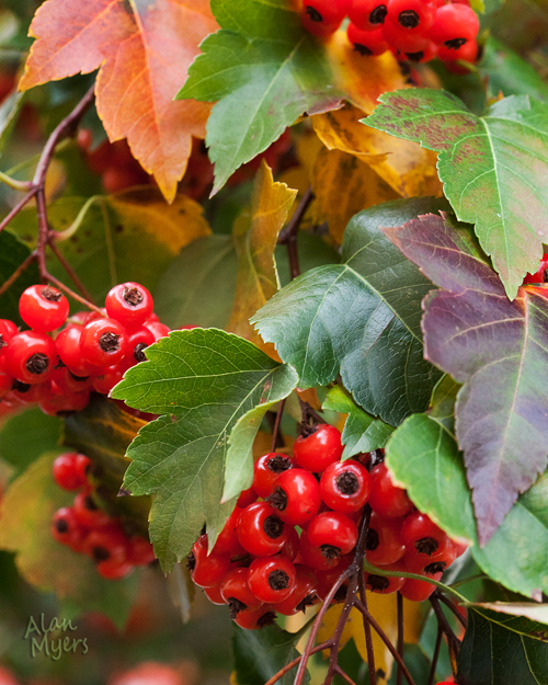

The single most useful filter you can buy is a Circular Polarizer. It can be used on sunny days to make the blue of the sky deeper and white clouds really pop out. It also is very helpful on overcast days, to reduce the reflection of the sky. You might be surprised by how much reflection there is off foliage, for example. Reducing the reflection of the white/gray overcase sky really brings out the color and contrast... of green leaved in Spring and Summer or all the varous reds, oranges and yellows in the Fall.
The image below, for example, was done in the shade with a C-Pol filter to help saturate the colors better...
