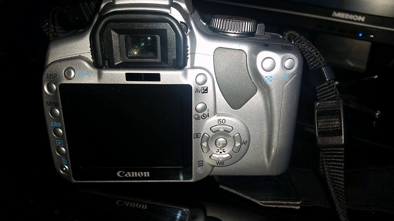

Hello I was on holiday luckily enough last few days. I cleaned the lens with lens cleaner, took lens off and used a small amount off solution and cleaned the glass angled mirror behind the lens, is that the sensor ? Since I have done this the camera takes pics however AF is very blurry MF works but in AF mode it just makes a small reving noise when it should be focusing if that makes sense
I am new to this however I have had this camera years and I taken some amazing pics of my kids but i can only narrow this issue down to what i have done. Due to my stupidity by using cleaner on there have i damaged the camera as a whole or maybe just lens ?

Ooh. It sounds like you bumped the mirror out of alignment. I think you need professional service. No new parts, most likley. Just a thorough checkout, and re-alignment, hopefully. Contact Canon Support at, 1-800-OK-CANON.
06-10-2016 09:12 PM
Sorry to hear about your problem, but it serves as a note to all - the mirror has no effect on picture quality. It folds up out of the way when a picture is taken. A small amount of light does pass through the mirror for the autofocus system. As long as the camera auto focuses OK there is no reason to clean the mirror other than to perhaps use a squeeze blower to blow dust out of the mirror box.
If you think the mirror needs cleaning have it performed by a reputable tech who will take responsibility if it gets damaged.

Yeah lesson learnt. Going to ring a repair centre canon emailed me about tomorrow, try and get a price.... if its high will just use MF but i am gutted.
Thanks for response
06-13-2016 09:47 AM
You can also use live view which does not use the mirror at all.
06-13-2016 09:51 AM - edited 06-13-2016 09:52 AM
would that AF still ? How do i try that please
£139 + vat to service and repair but may need new parts so could be higher
06-13-2016 09:56 AM
press the live view button. The one that looks like a camera. You get AF, but it is contrast detection, not phase detection, so it is slower.
06-13-2016 10:13 AM
I cant find live view botton on my 400d
06-13-2016 11:01 AM
Oops, sorry, you do not have live view. You will have to get the camera serviced.
