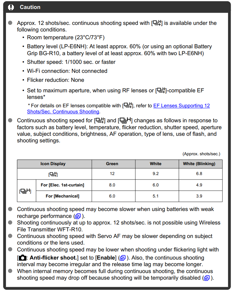

What was the first problem is not clear, maybe because the firmware was not updated the LP-E6P was not recognised and maximum fps were lower, like when the charge drops and you get the H+ blinking(in MS/EFCS).

Besides, there is no way to have no sound in MS/EFCS, if you hear nothing the shutter did not move ergo no picture taken so op must have been mistaken, also "battery couldn't shoot at 1600" makes no sense to me, not shooting at max fps(12) would make more sense, like this(for the OP)

Seems you still confuse shutterspeed(Tv) and drive mode(fps, single,H,H+ etc.)
Using a shutterspeed 1/1600 or 1/2000 doesn't deplete your battery faster and you won't hear a difference.
Why don't you set your drive mode to H+? This will give you(with full battery and mechanical shutter etc.) a maximum fps(frames per second) of 12(see my earlier post).
I'd advise you to invest time in reading your manual(if you've not got a paper one, find it here https://www.usa.canon.com/support/p/eos-r5 ) and watch some set-up video's(google canon R5 set-up video)
