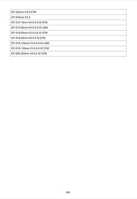

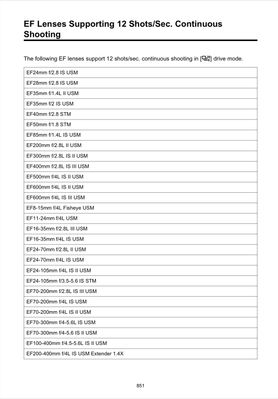

Greetings. Congrats on the new camera. The issue is most likely that the lens is not capable of the high performance the camera is capable of producing. I would not recommend using frame rates that high as H+ demands.

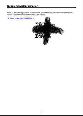

There should be a page in the User Guide after several pages of tables of contents that looks like this.
The links should take to Suppkemental Information about the camera. Here are older screenshots from User Guides that included lens compatibility tables. Just because a given lens is not listed, doesn’t mean it won’t work. It means camera performance will degraded in some way.

The list of lens in the supplemental guides is now online in the https://cam.start.canon website.
There are three models of the EF-S 18-135mm lens, introduced between 2009 and 2016.
The key difference is the focus motor type between the three models.
The Canon supplemental information from cam.start.canon only shows the later STM and USM motor versions as compatible with high speed shooting. Which lens do you have?
