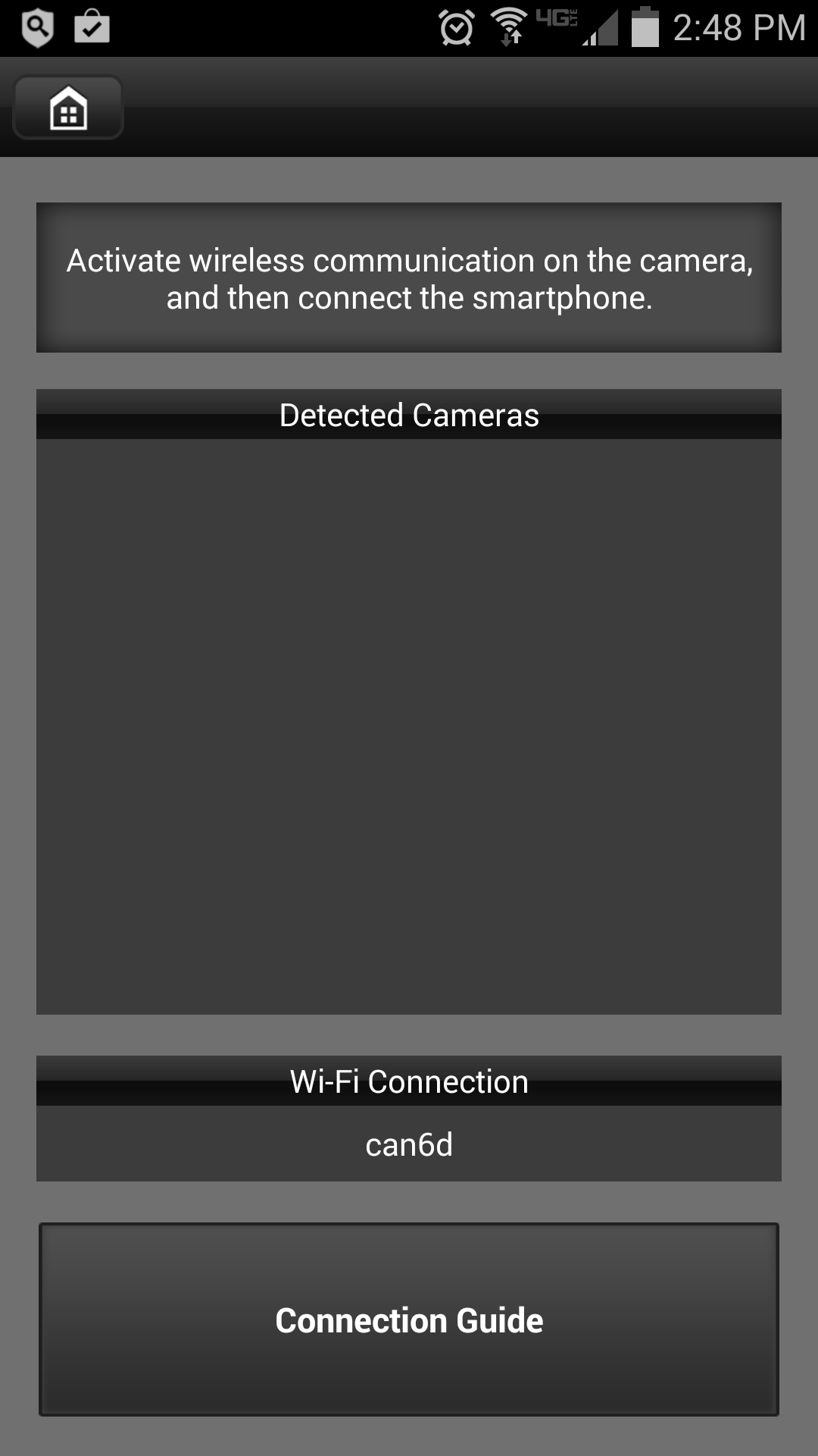

06-13-2014 05:01 PM
Everything works great until I get to step 13. Nothing shows up under Detected Cameras. See pics below
