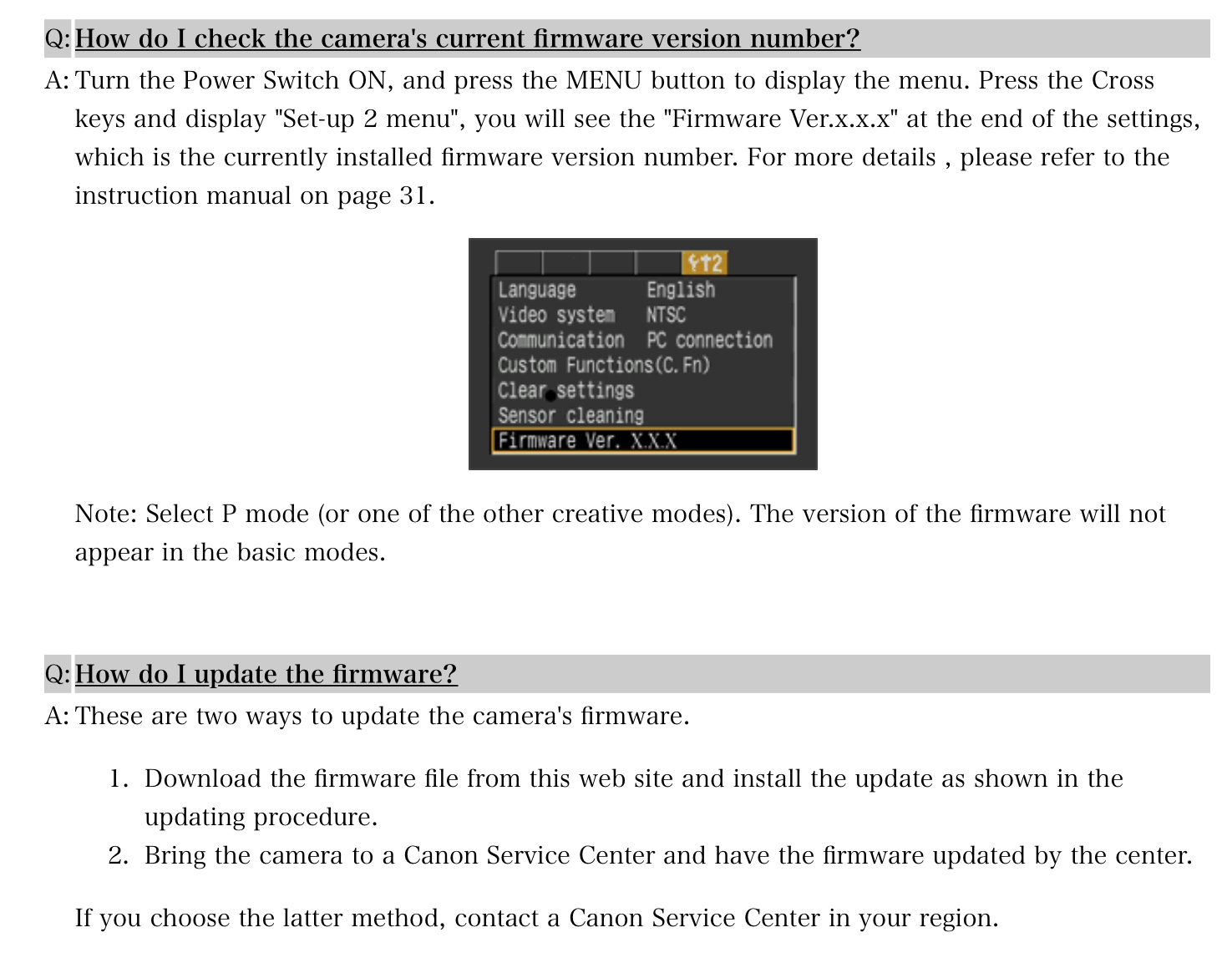

There is never a “need” to update the software on a camera. Canon will sometimes release updated firmware (software) to correct minor problems or add additional functionality to a camera. (it is actually called firmware not software)
If you had a pop up message on you computer screen, I suspect it was most likely was some form of computer virus and nothing to do with your camera.  I would think that if your camera works at all, there is nothing wrong with the firmware on your camera.
If you are curious, you can go into the tools menu on your camera to check which firmware version is installed on you camera. The latest firmware release for the Rebel XT was 1.0.3
If you currently have 1.0.1 or 1.0.2 firmware on your Rebel XT, you can update directly to the 1.0.3 firmware by going to the Canon website and downloading the newer firmware to your computer.  Then follow the detailed instructions to install the new firmware. In most cases it is more trouble than it is worth and I would not recommend you do it yourself unless you really enjoy the challenge or really need the updated functionality of the latest firmware.

Whatever a pop-up or not it was not from the camera.  The camera doesn't tell you to update FW.  The FW has to be d/l from Canon and usually put on a CF card.  It is inserted in the camera and you use the menu to update.  This is the best way to do it.  If the update goes awry only Canon can fix it.  I don't know if they still work on the XT. But a call to Canon Support at 1 (800) 652-2666 will tell you.
