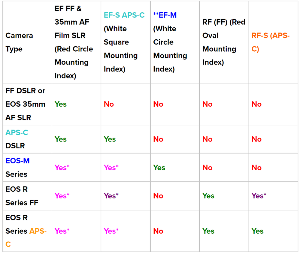

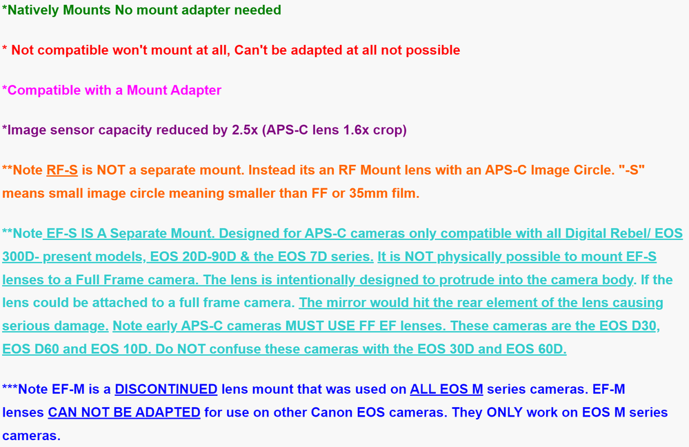

Yes and no. The EF 70-200mm F/2.8 lens lineup will work on both cameras. But EF-S lenses will only work on the Rebel T7. They won't physically mount on a full frame camera. EF & EF-S lenses can be adapted to EOS R series cameras. By using the EF-RF Mount adapter. The RF Mount is the future. The EF Mount will no longer have any further upgrades anymore. All new features will be in the RF Mount from now on.
Lens compatability pt. 1.pngLens compatability pt. 1.pngLens compatability pt. 2 .pngLens compatability pt. 2 .png

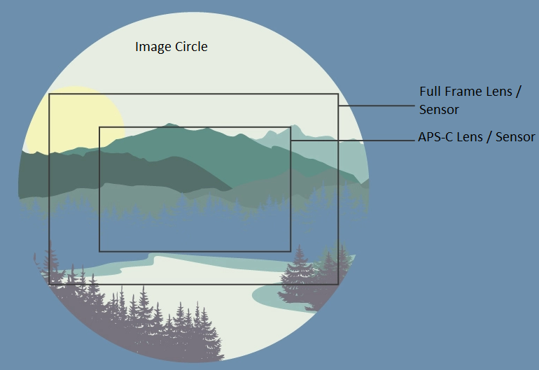

Why we need to know what lenses you have now.
EF-S lenses are intended for cameras with an APS-C sensor (Like your T7)
EF Lenses are intended for full cameras with a full frame sensor. (like a 6DmkII)
You can use EF lenses on a APS-C based camera.  Using a EF-S lenses on a full frame body is not typically desirable.  Here's why.
Look at the image circle above.  When you put an EF or lens intended for a full frame sensor you get a much wider field of view.  The image this lens projects to the camera's sensor is larger and utilizes the full height and width of the sensor.
Now look at the image circle with a EF-S or lens intended for a smaller APS-C size sensor.  Notice this type of lens has a more narrow field of view and the image it projects is smaller and intended for a smaller APS-C sensor.
By using a APS-C lens on a full frame camera you are effectively decreasing the resolution the camera is capable of capturing.   This is because the image the lens is capable of displaying to the sensor is not the full height or width the larger sensor is capable of capturing.
Here's an example.  You have a full frame camera that has 24MP.  You put a lens on it intended for full frame sensor, your images can be 24MP.
Now put a EF-S lens on this same body.  The image that lens projects to the sensor is smaller.  Its cropped at a 1.6x ratio.  So instead of using the sensors full 24MP ability, it can only use 9.3MP.  Let's say you purchased an R5.  Now you have 45MP, but you'll only get 17.5MP images from it if you put a APS-C lens on it.  So your resulting images will be much lower quality.  If you are going to buy a new camera, let's not cripple it.  😀
