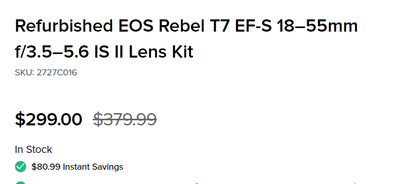

It might very well be the focusing screen or something else as @Demetrius pointed out.  I would not attempt to fix it yourself.
Start with MyCanon.  Register the camera.  Then select support and repair.  Send the camera in for an estimate.
MyCanon
Let Canon tell you what's wrong.
If the cost of shipping and repair exceeds $299
Then
Shop Canon Refurbished EOS Rebel T7 EF-S 18–55mm f/3.5–5.6 IS II Lens
