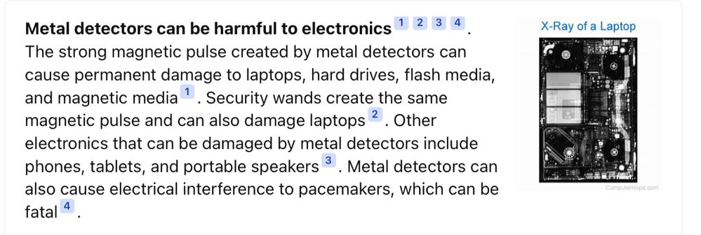

Did your camera pass through an x-ray machine or explosive device scanner?

The airport scanners do not have any effect on SD memory cards.
“ The airport scanners do not have any effect on SD memory cards. “

"Did your camera pass through an x-ray machine or explosive device scanner?"
SD cards are not like a HD. Metal detectors don't bother them either. It also seems like the OP's camera is just fine, too, so there is no electronic failure either. It also seems unlikely that an airport scanner and/or metal detector would erase 1000 photos and leave 1000 photos unharmed. This was not the case and there is some other reason.
