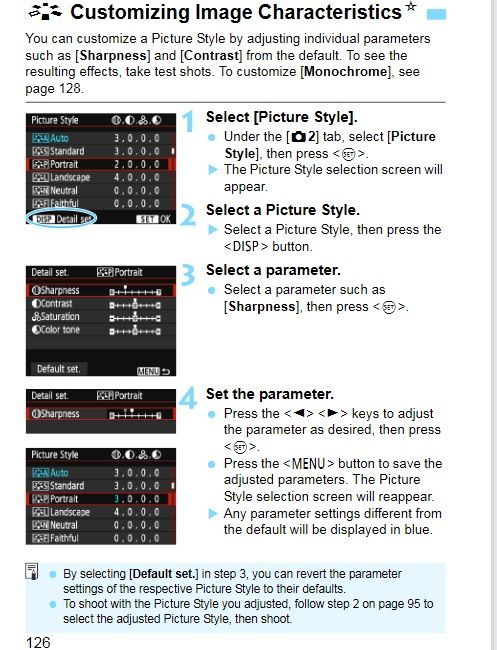

A filter won't help with that. You need to either fix it with something like DPP or photoshop or change the picture style:

Thank you for the information, these customizing image characteristics are in the camera?

I see from the EXIF you used the Portrait Picture Style. The Portrait PS reduces the camera base sharpness setting to provide a smoother look to skin. It would be more suited for head shots where the subject's face is a large part of the image. For the setting you have you might try Standard as well as possibly fine tuning the Picture Style as kvbarkley showed.
