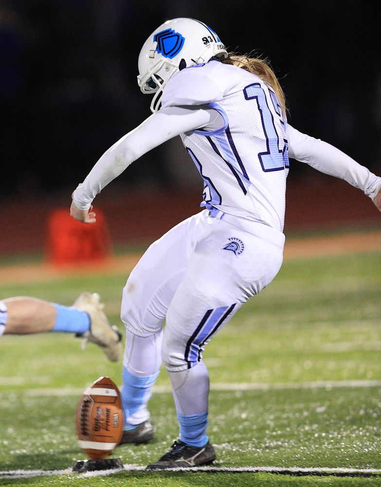

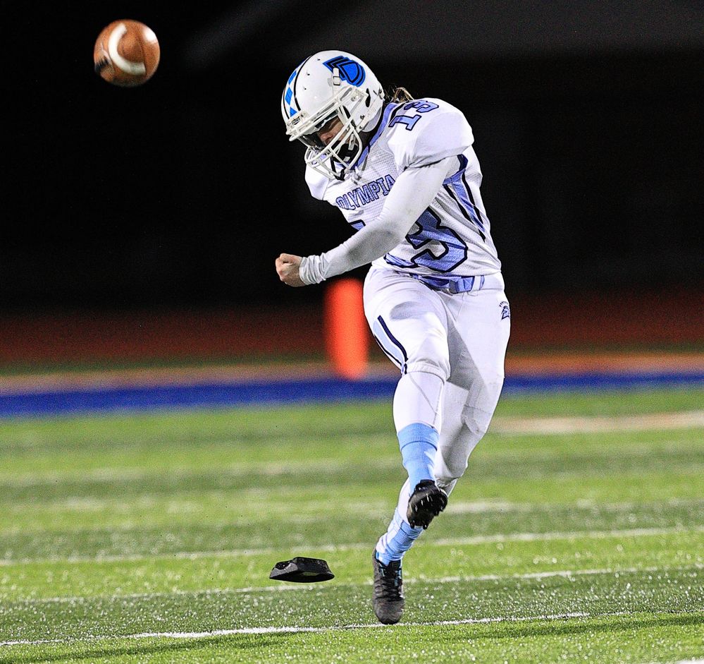

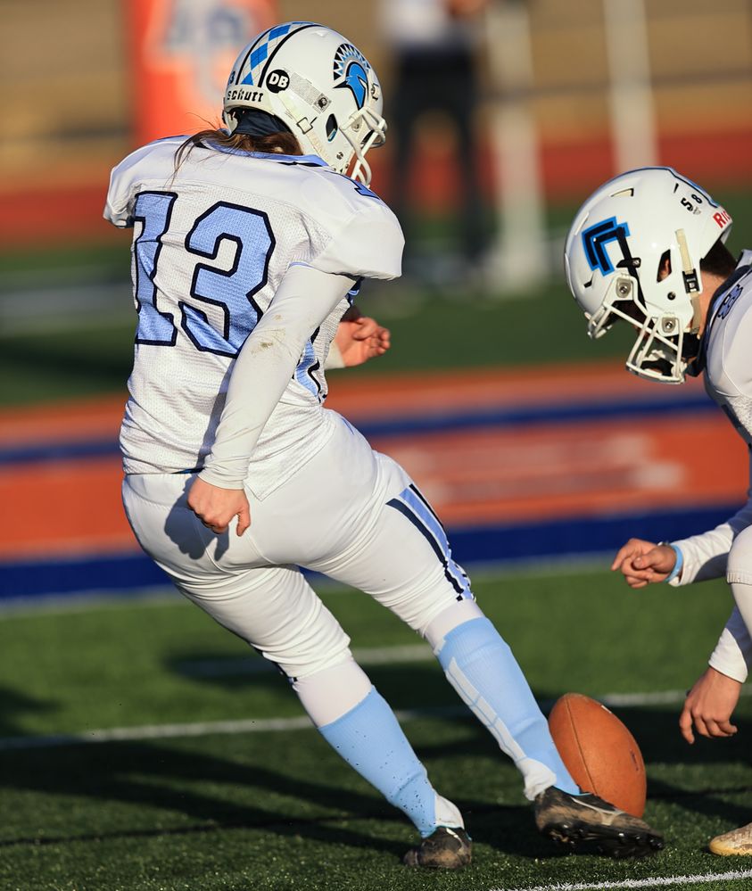

But for kicking, the moment of contact with the ball often doesn't result in the best photo and typically more interesting is the "power pose" of the player with kicking leg back preparing to make contact or with the kicking leg follow through with the ball still in frame.  My daughter was recruited from soccer to do kickoff, field goal, and point after for the football team during her sports shortened Covid junior year of high school.  The first two photos were captures of foot to football contact using precise timing and I captured several of those during the season but I preferred images captured before and after contact which I think better present the power of the kicker.
