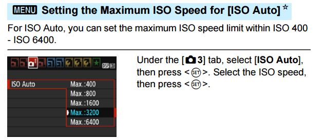

1. First I'd want to determine the maximum ISO setting I'm willing to live with.  For your camera, probably ISO 1600.  Set an upper limit of ISO to that setting.  When I shoot, I'd set my ISO to Auto and let it vary up to the max ISO as needed.

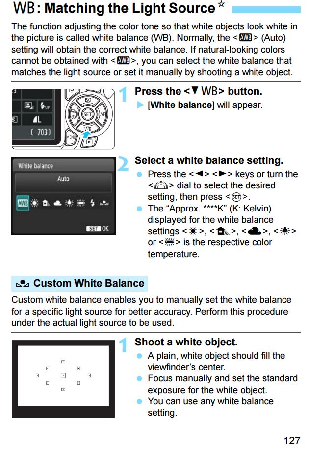

3.  Unless AWB produces perfect colors, I'd adjust the white balance manually to get the pictures to look right on camera.

I have to set the camera to Tv first, correct? then hit the Q button and set it to 1/1000. then toggle to ISO and set to 1600 . Is that right? then, toggle to AWB. How do I adjust the AWB manually?
Not exactly what I said regarding ISO.  I said set the camera to AUTO ISO after you put an upper limit on ISO (a camera option).  When there is light, you don't want your ISO set to 1600 all the time.
Regarding white balance, if you post-edit your pictures, you can do them there.  If you don't you need to switch WB to manual and adjust it.  The way I do it is switch to Manual white balance, set the initial temperature to around 3000 or 4000.  Switch over to live view and adjust the temperature up and down until the colors look right.  Sounds complicated but can be accomplished in seconds.
