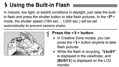

Is this issue occurring when you have pressed the flash button on the side of the central
 You can try manually releasing it by turning the <MODE DIAL> to the [P] mode, then pressing the <FLASH> button located near the lens mount just below the flash on the front of the camera.
If that does not work, press and hold the flash release button and gently use a fingernail under the joint between the flash cover and the camera body to see if it will release - it may have got stuck from lack of use or dust ingress.
