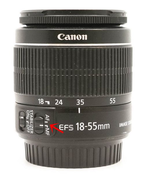

Sorry I have to ask, is the switch on the lens set to AF? In the image below this lens is set to MF (Manual focus).
Can you focus the lens manually?

No, it's completely okay to ask, but yes the lens is set to AF.
01-26-2026 09:36 PM
@itskaradude Check the AF/MF switch on the right hand side of the lens barrel. When looking at the camera from the lens side. Ensure it’s set to AF. Note this lens does NOT support what Canon calls “Full Time Manual Focus”. So NEVER turn the focus ring without first setting the lens AF/MF switch to MF. This can result in damage to the lens’ gears and AF motor. Note the last 2 versions of that lens say “STM” in the name. Those lenses support full time manual focus. These lenses are “Focus By Wire”. Meaning the focus ring isn’t physically connected to the lens’ focusing elements. Instead the lens’ AF motor handles MF. The lens requires power for MF to work.
