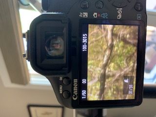

Shutter Results without M Mode

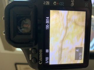

Shutter results in M Mode

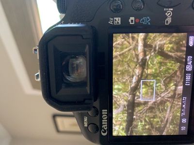

Pic in Viewfinder

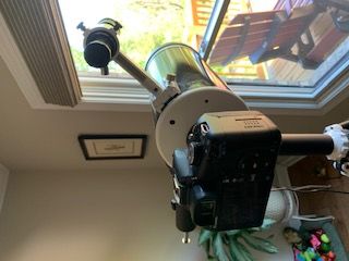

Camera Setup
I think that by taking these pics I found a workaround. In Manual mode I get the white glare shown in the pic. But when I switch out of Manual to the other modes (Av, Tv, A-Dep) it gives me the same image as in the viewfinder. So I guess I won't use the Manual mode to make it work. Thanks.
