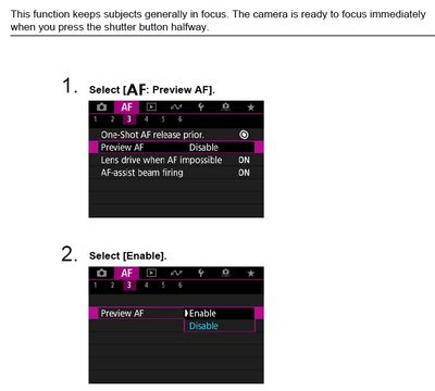

Just a guess, but it will only take a second to check. See if "Preview AF" has become enabled. Page 480 in the users manual.
Newton
04-30-2024 10:23 AM
Appreciate that. It was already on "Disable"
