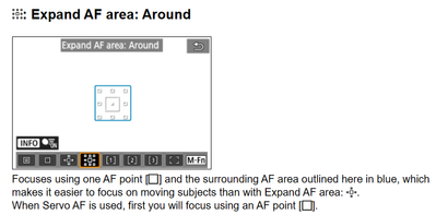

I can't get to Expand AF area: Around.
The cursor jumps from Expand AF area to Flexible Zone AF 1
What's the solution?

The term Around is where it says in the manual.
I use  "One Shot" mode.
The cursor jumps from Expand AF area (3rd from the left) to Flexible Zone AF1 (%th from the left)

I think I understand what your are trying to ask...
Are you saying that when you go to select Expand AF Area, within that menu, it goes to Flexible Zone AF1.  That is not so much that it does it when you are shooting, as when you are trying to set up the focus options in the menu?
cheers, TREVOR
My question is: why it by passed the Around option?  and how can I get it back?
OK, I think I now understand your issue.  If it's simply that the option for Around is not available then I suggest going to the Purple Focus menu, Tab 4, 2nd from the top is Limit AF Areas.  Check to see if the Around option and any other options are not ticked. If it is not, then that is your issue.  If you want to remove options that you are sure you will not use, then this is the place to do it.
