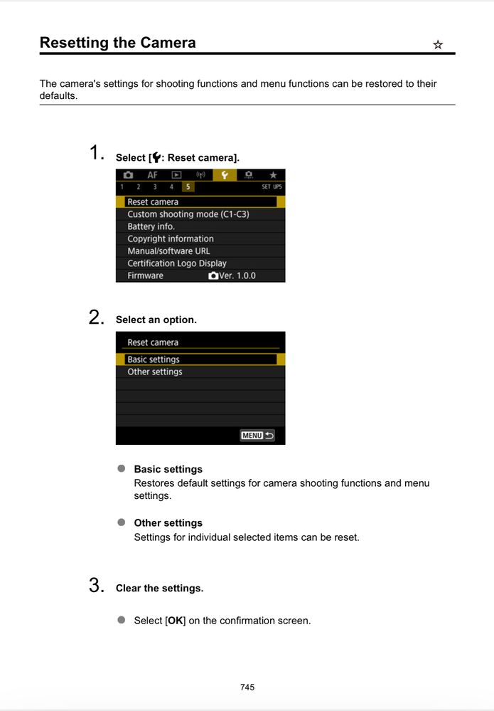

Use a fully charged battery. Set the top dial to “P” and then turn on the camera. Go to the “Wrench 5” menu, and select [Reset Camera]. Perform the “Basic Reset” first. Select “Other Settings. Go through the list of settings, and reset each one. Perform the “Basic Reset” one last time.
