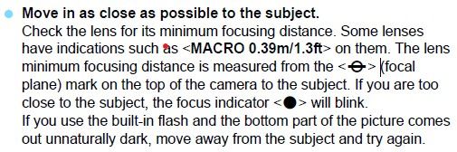

06-19-2023 06:24 PM - edited 06-19-2023 06:25 PM
The sensor focal plane is marked on the camera body. You can measure from that mark to the lens flange. Focal Plane symbol is shown below:
