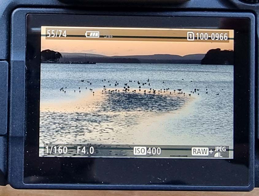

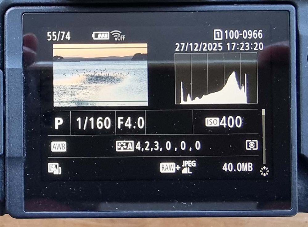

HI, I'm having a curious issue with my R7 LCD screen. Two horizontal grey lines appear on the screen, approx. 1mm in size, one at the top, the other the bottom, about 2mm from the edge. They appear no matter the what configuration the display "Info" is in, including the thumbnail on the histogram display. They do not appear in the actual images, through the viewfinder, or if you touch the screen to (say) flick through captured images. Apart from this, the camera appears to work OK.

Could you take a picture of what the lines look like.
Here you are. Lines only appear when the LCD is in this mode. As you can see, if I touch the screen to move to next image, the lines disappear.20260107_092506.jpg20260107_092506.jpg20260107_092517.jpg20260107_092517.jpg20260107_092631.jpg20260107_092631.jpg20260107_092708.jpg20260107_092708.jpg
