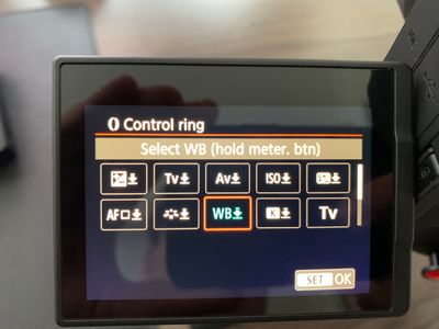

I have a EOS R6 with a RF 35mm F1.8 IS Macro STM Lens.
When I go menu -> customisation -> 3 -> customise dials and select the control ring I have options to change Tv, ISO, Av etc. You can pick to use the "hold meter. btn", but this is not working for all options. When I pick WB, Color temp or Picture style, they are not working while holding the meter. btn. They are working when you select these options without holding the meter. btn.
When I pick let's say ISO+hold meter btn it is working as intended. But holding the meter. button with WB,Color temp or picture style is not working for me. I chose different Mode dials, M, AV, Automatic, none of them is working.
I guess this is a bug? or is this intended behaviour?

I set the following:
The control ring on the lens works:
Is set the WB with the meter. btn like this:
When I hold the meter. btn and dial the ring nothing happens. To be clear I assume this is the meter. btn (at the bottom front, near the lens):
When I set AV+meter. btn, like this:
Changing the aperture value is working while holding the button (so that rules out the button is broken).
Hope this is enough to reproduce my issue.
