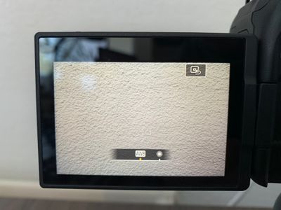

Is set the WB with the meter. btn like this:
When I hold the meter. btn and dial the ring nothing happens. To be clear I assume this is the meter. btn (at the bottom front, near the lens):

Greetings: I was attempting to solve a similar issue and came upon this older thread. I was attempting to use the control ring for exposure compensation but it wasn't working for me, yet WB and ISO adjustments were working fine.
The issue for me was I had the camera in manual and there was nothing for the camera adjust to effect exposure. My solution is to set ISO to Auto but I could have just as easily automated shutter speed or aperture or any combination of these for the ring to work as intended.
I believe your issue is WB was set manually and the fix, therefore, would be to change the setting for WB to auto and the control ring should then work with a half-press.
