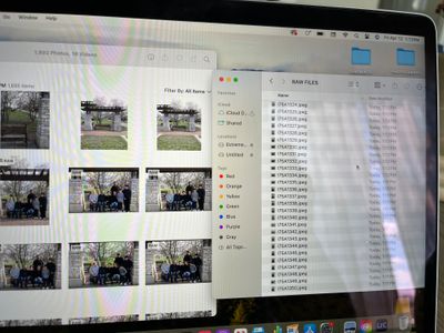

Hi! I have a Canon EOS R6. I shoot in RAW (only, no jpeg). When I plug my SD reader/SD Card into my MacBook Air and open the photos app, it shows that the images are RAW. But when I drag them to a folder in my external hard drive, it shows up as a jpeg on my hard drive. I didn’t catch this before I edited photos and have sent off 3 galleries. I edit my photos in light room classic. Will my clients have a hard time blowing up photos? Do I need to completely re edit all of the photos? I’m panicking!

04-12-2024 08:09 PM

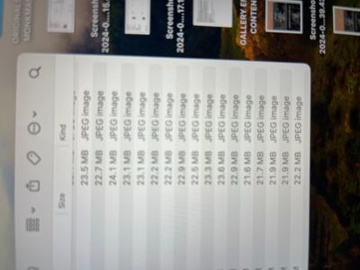

so the last photo is what I am seeing. They say “Raw” when I import them into the photos app on my MacBook, but once dragged they have the JPEG extension. I also included a picture of MB of each photo. I am super new to photography, so I definitely could be doing this all wrong!

ashleemassey,
You'll have to forgive me, I don't know anything about R6's or MacBook, so I'm flying kind of blind here, but 22 and 23 megabyte jpg's seem kind of high.
That seems sort of like a compressed RAW file size. Most of my jpg's run in the 6 - 11 megabyte range. Full RAW files run in the 30 - 40mb range, and the C-RAW (or compressed RAW) files run in the 20-23 mb range.

04-12-2024 09:05 PM
Yes (I think so)! When I drag the RAW files to the folder on my external hard drive, I usually batch select 15-40 photos at once and then drag and drop into the external hard drive folder. Do you think that could be messing with it? I really appreciate you taking the time to give me pointers and help!!
