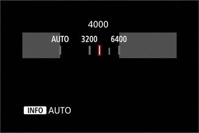

The earlier post by Brian that included the following screenshot is telling.
The ISO has been set to a very limited range, 3200 to 6400. Note that Auto is an available option. The ISO Auto option is always available. The user cannot manually increase the ISO above 6400. However, the can decrease the ISO to 3200, and one more click of the dial will set ISO Auto.
As Brian further points out, once ISO is set to Auto, the available range of available ISO settings is defined by a different setting!

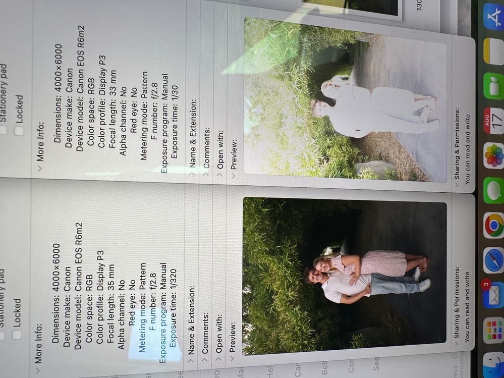

these were taken one right after the other, I didn't move- clients didn't move, I didn't change settings. It does this EVERY few minutes. I'm so done with it.
08-20-2025 09:20 PM
If all of you with those issues could show us there two menu screens, please, it would enable us to give you a much more definitive answer (this is from a response earlier in the thread): Thanks!
08-20-2025 09:23 PM
Need the full exif data to help. Clearly this is jump in Tv that has caused the issue, but there is no ISO gain info in your illustration, nor information on the other exposure controls in the camera.
