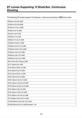

If you are using the electronic shutter for H+ continuous shooting, then I would recommend switching back to the default shutter mode for a couple of significant reasons.
First, just because the shutter may fire in H+ drive mode will the electronic shutter does not necessarily mean that the camera was able to lock focus on the subject.  The adapted Canon EF mount lenses wete designed for camera bodies capable of frame rates as high as 10-15 fps, not 30-40 fps.  This is true of mostly the Mark II L series lenses.
Second, if you’re going to be frequently shooting indoors under artificial lighting, then the light flicker compensation setting will be disabled when using the electronic shutter.
I use the default shutter mode almost exclusively with the R6ii for this exact reason.
I am uncertain about whether or not Spot AF focus mode can focus anywhere except for the Center AF point.  Even if you enable Whole Area Tracking, the camera may only use the Center AF point regardless when Spot AF is selected.
A common misconception is that Spot AF will focus more accurately than 1-pt AF.  Spot AF simply looks at a much smaller area to lock focus. The only scenario when I use it is for macro photography using a tripod.
