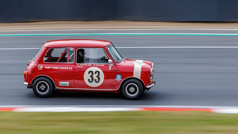

Here's an example with mode 2 selected, IS on the lens switched on, so body IS will be active.
1/30, f/14, ISO 100 EF 70-200mm f/2.8L IS II USM

Nice shot!

Good explanation and nice example photo.

IS comes into its own at slow and very slow SS. The Mini was shot a 1/30 SS so I would have used mode 2 with IS on.
