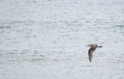

Hey trevor, sorry I didnt clarify much earlier, I most commonly use a sigma 30mm f/1.4 or a canon 75-300 f/4-5.6 (I know that lens may be my issue) with a canon brand ef-rf control ring adapter, I also usually shoot through the viewfinder unless i’m doing low angle or high angle shots. When it comes to subjects I’m shooting, I usually take pictures of landscapes or animals. I’ll attach some photos.

07-26-2023 03:06 PM - edited 07-26-2023 03:08 PM
This photo does not have much blur. I see a halo from unsharp mask. I might reduce both the radius and amount for unsharp mask and maybe also increase the threshold, but that is a matter of preference.
Did you import a raw file or a JPEG into lightroom? If a JPEG, then one should likely not do unsharp mask both in camera and in lightroom. A second unsharp mask might be useful after resizing an image or before printing. If importing a raw file into lightroom, then use the radius, detail and masking sliders for sharpening in lightroom. https://helpx.adobe.com/lightroom-cc/how-to/sharpen-photos.html
