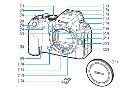

when you mean custom dial 2 what precisely are  you referring to?  The default to change EC in Canon cameras has been what is shown here as Quick Control Dial 1.  Do you wish to move that Exposure Compenstion function to the other dial in front of the shutter button, which Canon calls the Main Dial - see item 3 lower image?
cheers, TREVOR
