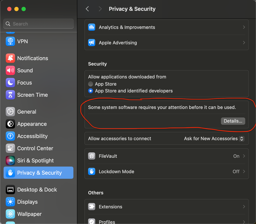

I solved the problem. It turns out that in the settings I needed to unlock the installer and reinstall the app.Screenshot 2024-04-20 at 8.26.38 PM.png

Hello,
I'm having the same problem. Would, please, specify how to "unlock the installer" and resolve the issue.
(I don't have the "some system software requires..." section in my security settings). Thank you in advance!
