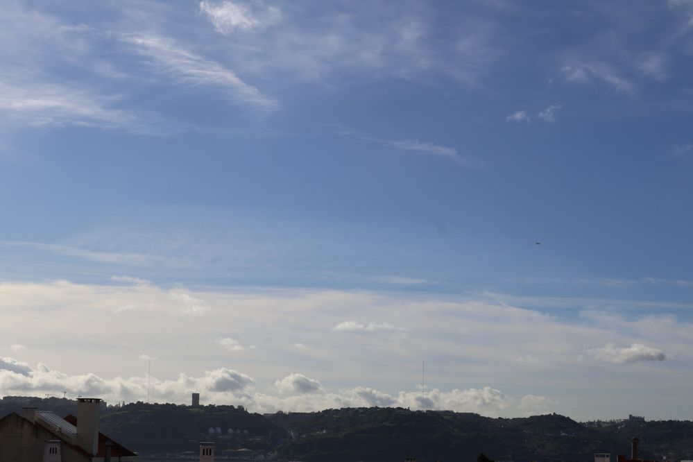

I got the camera on september 25th, purchased refurbished online, and since I haven been travelling for work, was only able to check it now. (see photo)

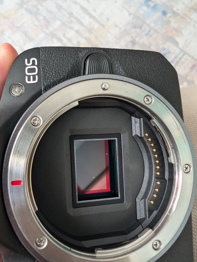

The first photo I took you can clearly see it has some dark spots. I took out the lends and spoted the sensor was having stains. How can you sell a refurbished camera with stains in sensor? (see photo)
I cleaned the sensor and there is still marks a dark spot. I see not marks at sensor.

Sensor spots are caused by small dust particles that enter the camera while changing/installing the lens. It does not indicate a "broken" camera. They tend to be most visible with a solid background like a blue sky and at smaller lens apertures. They can be removed first by trying blowing with a device like a Rocket Blower (do not use canned compressed air). More stubborn ones might require the use of a sensor cleaning system. Do not rub the sensor or use any liquid other than a quality sensor cleaning liquid. They can also be eliminated during post processing.

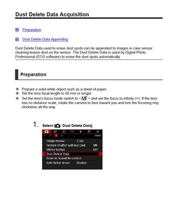

You didn't say what model camera you have, but many have a menu setting where you can use Canon DPP4 software to remove during processing. You can also just clone them out.
