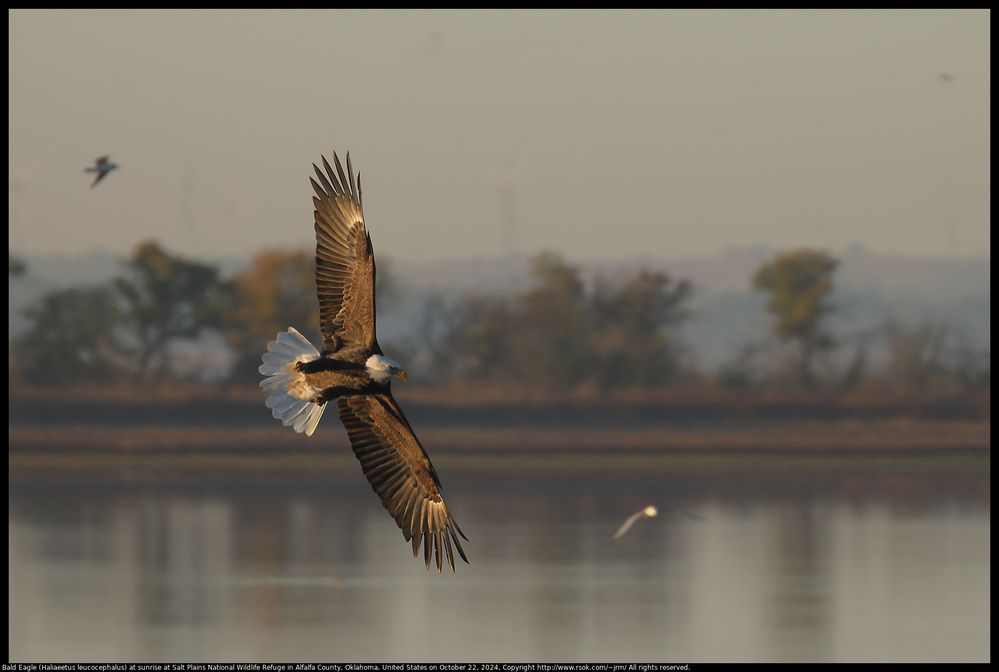

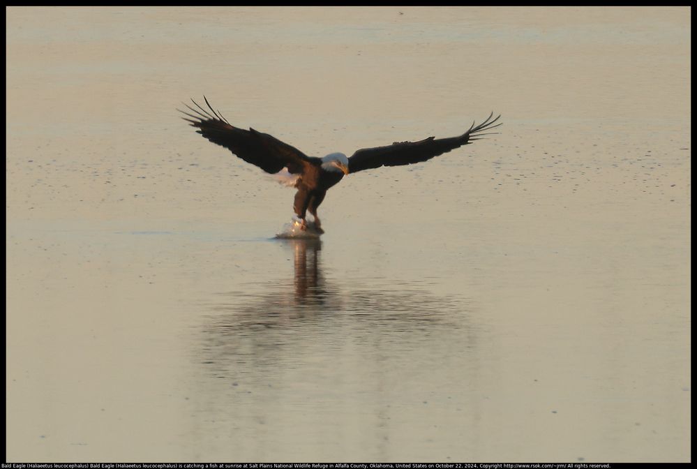

These 2 images were made with my EOS R5 of subjects between 300 and 600 meters distant.  The bird that is higher above the water has less noise than the bird at the surface of the water. The distant shore line in the first photo is more than 1 kilometer from the camera.
I processed both photos using Canon DPP software. Noise reduction, increase saturation, DPRAW focus distance adjustment, unsharp mask with radius (fineness) larger than the noise, and digital lens optimizer.
https://www.rsok.com/~jrm/2024Oct22_Salt_Plains/2024oct22_eagle_IMG_2015c.html
Bald Eagle (Haliaeetus leucocephalus) at sunrise at Salt Plains National Wildlife Refuge in Alfalfa County, Oklahoma, United States on October 22, 2024  ;  	EF100-400mm f/4.5-5.6L IS II USM +2x III ; 800.0 mm ; 1/400 second ; ISO 500 ; handheldBald Eagle (Haliaeetus leucocephalus) at sunrise at Salt Plains National Wildlife Refuge in Alfalfa County, Oklahoma, United States on October 22, 2024 ; EF100-400mm f/4.5-5.6L IS II USM +2x III ; 800.0 mm ; 1/400 second ; ISO 500 ; handheld
https://www.rsok.com/~jrm/2024Oct22_Salt_Plains/2024oct22_eagle_IMG_1946c.html
Bald Eagle (Haliaeetus leucocephalus) is catching a fish at sunrise at Salt Plains National Wildlife Refuge in Alfalfa County, Oklahoma, United States on October 22, 2024 ; EF100-400mm f/4.5-5.6L IS II USM +2x III ; 800 mm ; ISO 800 ; 1/400 second ; handheld ; F/11Bald Eagle (Haliaeetus leucocephalus) is catching a fish at sunrise at Salt Plains National Wildlife Refuge in Alfalfa County, Oklahoma, United States on October 22, 2024 ; EF100-400mm f/4.5-5.6L IS II USM +2x III ; 800 mm ; ISO 800 ; 1/400 second ; handheld ; F/11 Frames with captions added using GraphicsMagick free software.

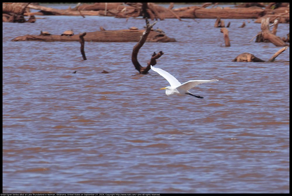

https://www.rsok.com/~jrm/2024Sep30_birds_and_cats/2024sep27_egret_IMG_1646c.html is an example of using a 2x extender with 1.6x crop handheld EOS R5 and panning. Background is blurred from panning as well as being out of focus.
Great Egret (Ardea alba) at Lake Thunderbird in Norman, Oklahoma, United States on September 27, 2024 ; EF100-400mm f/4.5-5.6L IS II USM +2x III ; 800.0 mm ; 1/640 second ; F/13 ; distance about 300 meters ; ISO 400Great Egret (Ardea alba) at Lake Thunderbird in Norman, Oklahoma, United States on September 27, 2024 ; EF100-400mm f/4.5-5.6L IS II USM +2x III ; 800.0 mm ; 1/640 second ; F/13 ; distance about 300 meters ; ISO 400
