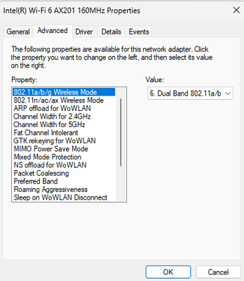

The first thing I would do is look at the driver's properties.  You can do this in Device Manager or on the Adapter properties itself.  Look for anything that might ensure backwards compatibility.  WPA2 (example)
Something in here for example:
You can also try disabling IPv6 as a test.  Total stab in the dark here.
You can also try updating the Wireless Driver.   Intel® Killer™ Performance Suite
