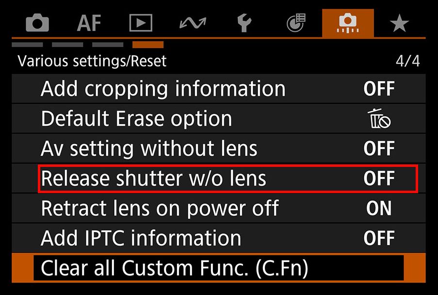

Hello all
Where can I find the function to enable release shutter without lens on my R5 Mark II? I scrolled through all the functions in the menu, and I don't see it at all. TIA
Solved! Go to Solution.

To add to Marc's instruction, be sure you are in one of the "creative" modes, like Av, Tv, M, etc. and not the A+ Full Intelligent Auto mode 🙂

To release the shutter without a lens attached go to the camera's custom functions menu as shown in the picture below. Highlighted in red, "Release w/o Lens", and enable it.

Thank you Marc. I found the function thanks to Newton's response. The camera has to be in other modes instead of A+ mode for it to show in camera's functions

Thank you so much. Your tip solved the problem.
