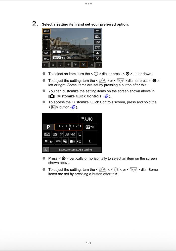

10-04-2025 09:36 AM - edited 10-04-2025 09:37 AM
Not true.
Eye Control, Silent Shutter via Quick Controls directly allow set the option On /OF.
They are not "shortcut to the menu screen" as you say.
See photos of the QC menu taken with my smartphone.
Canon desing team has offered direct On/Off access via Quick Controls to some option and not others.
Perhaps there's a reason but is nonetheless an inconstancy that users have to pay for.
So "Pre-Continuous shooting" could be the same as "Eye Control" and "Silent Shutter" and offer direct On/Off as my OP suggests.
(Perhaps other options are the same and have not been given "direct access", need to check, don't have time right now).
10-04-2025 10:07 AM
I realise that to match other icons the "Pre-Continuous" icon in Quick Control would have to be in two state, the following;
ON and Off
10-04-2025 10:45 AM
I see now that we were talking about two different types Quick Control screens. Both are referred to as Quick Control screens.
