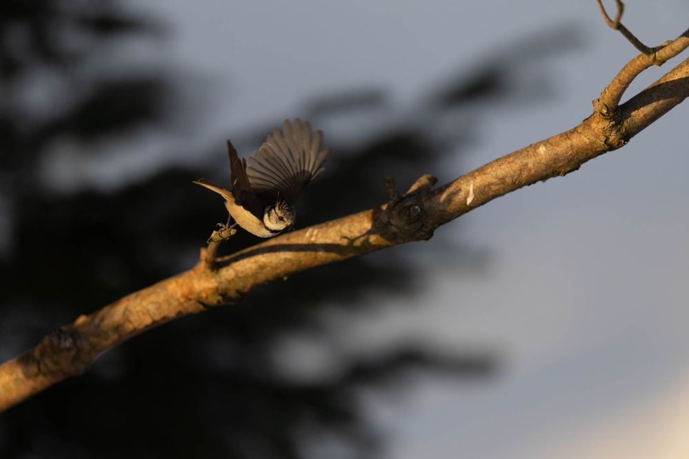

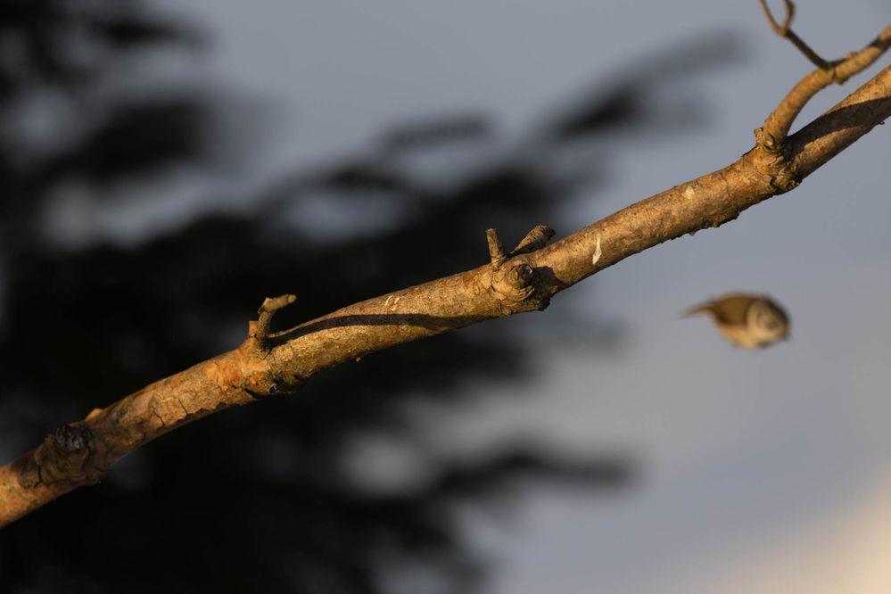

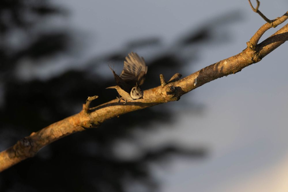

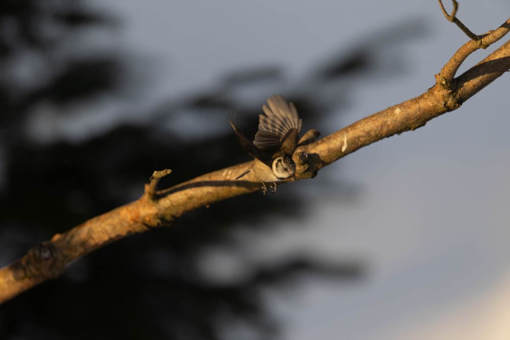

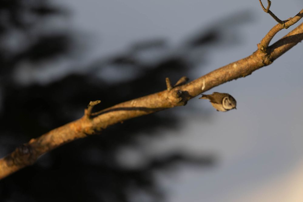

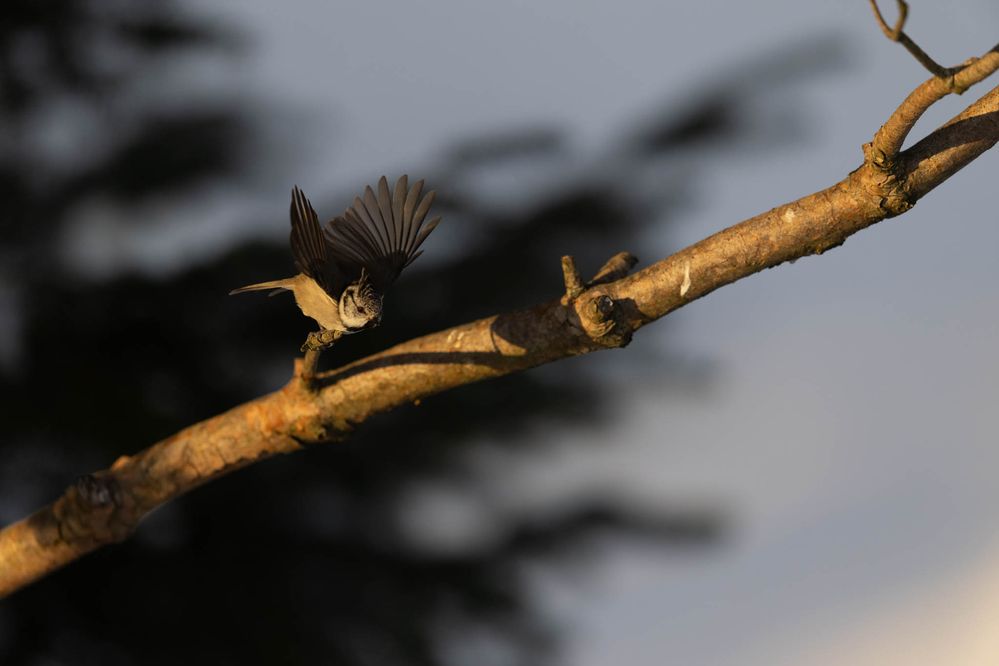

Came from R5 to R5 mk ii and was hoping that the focus would be faster to follow birds flying e.g. from a branch, but I am struggling to make it work.
See below series as an example. Here I am using pre-capture to be able to get the flight. I am using back button focus. As you can see, even if i continuously press the (eye) focus button, the camera does not follow the bird as it takes of, but continues to keep focus where it originally was. Is this to be expected? The bird is very fast, so it might not be fast enough to follow it this closely? The lens is EF 600 f/4 II and the photos are uncropped.
Any thoughts?

First a disclaimer:I've never used R5 models.
My first guess is the camera didnt recognise the birds eyes or perhaps didn't recognize the bird at all.It's a similar color to the branches.Unfortunately i couldnt get the focus points to show on the images you uploaded.
Before pressing the shutter,did you notice what the camera was focusing on? It should look like a tiny box centered on the bird's eye or body - https://youtu.be/Yqhzla0D0Oc?t=2949

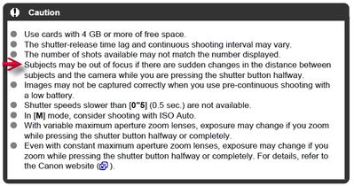

There is this "Caution" in the pre-continuous notes, but I'm not totally clear on it's meaning. The Japanese sometimes make it hard to grasp what they are getting at, LOL!

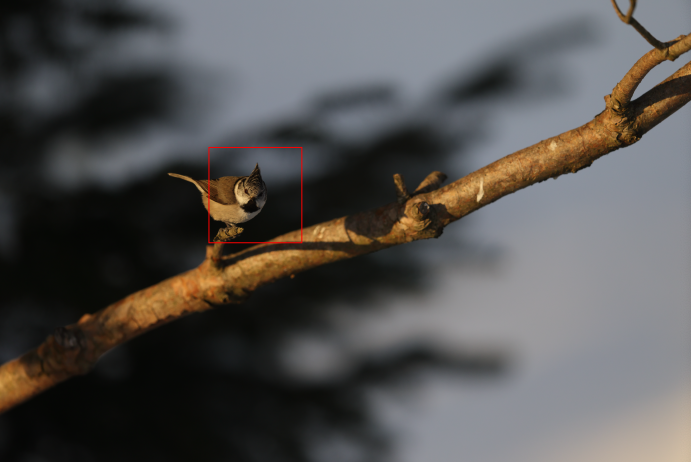

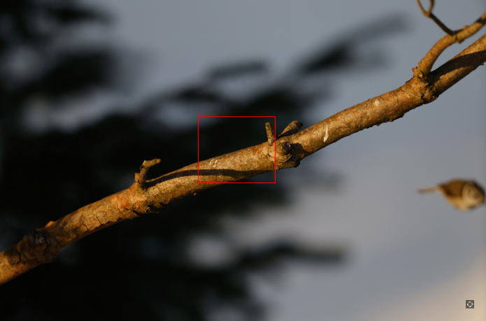

I think Af escaped. If possible, you can check where Af stuck with DPP (Digital Photo Professional) and share the screenshot. After the 5th photo, it seems like Af stopped following or stayed at another point.

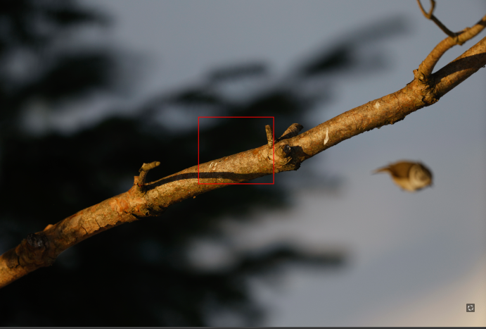

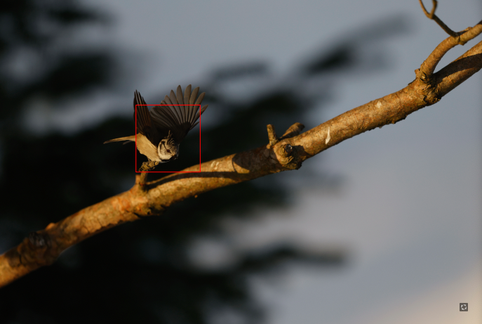

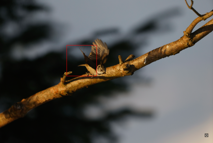

I will post the series with AF points showing from DPP. It seems that the camera could not keep the bird in focus. Maybe the camera is not able to operate eye focus this fast...
01-12-2025 01:37 PM
Here are the series with AF point showing from DPP. Seems like it cannot follow the bird somehow...

From looking at your images with focus points displayed, that is a bit more than I expected. I thought there would be some lag, like, just enough to not include the bird in the DOF or maybe that focus was lost and locked on to something else.
Which AF area are you using? Like Spot, Expand, one of the Flexible Zones, or Whole Area AF. Do you have "Whole area tracking Servo AF" enabled? I ask because it almost looks like your focus point hit the edge of your AF area and stopped.
