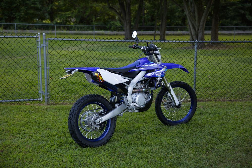

Can someone please tell me if they would use the distortion correction for the 4 sample images below? I am unable to determine which is better or more correct. I understand that distortion correction is both objective and subjective.
Thank you!
With Lens Correction (50mm)
Without Lens Correction (50mm)
With Lens Correction (35mm)
Without Lens Correction (35mm)
With Lens Correction (24mm)
Without Lens Correction (24mm)
12-16-2025 10:53 PM
I vote yes. I ran the series zoomed in on a 32" OLED monitor and scrolled back and forth on each image to notice changes. I notice that it corrects some pincushion. That's all that I can see. Correction appears to me to be most noticeable on the horizontal galvanized fence rail behind the motorcycle and the dog closeup. The ccorrection does some cropping around the edges. But the correction levels out the horizontal fence rail that appears slightly bent without it. I think the dog benefits from the more accurate distant surroundings, which I find a bit more pleasing to my brain, though I would not really ever notice the pincushioning in that shot. I don't notice anything significant in the lake scene and don't notice the horizontal or vertical lines changing enough to make much of a difference in the monument picture.
The only times that I would personally ever NOT use the correction would be a) I wanted a slightly pincushioned area surrounding a center focal area (and I cannot really think of an example of what that might be, but I can imagine intentionally pincushioned dark lines on a light background somehow being a possible desirable artistic effect) or b) the slight cropping of the edges that comes from correcting the pincushioning removed some edge detail that mattered to me more than the pincushion.
I cannot discern any other correction occurring.
