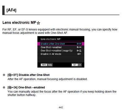

I am not sure if these apply, but check these settings in the auto-focus menu. Also download the lens manual and see what it says about manual focus for your lens.

I can't figure out which setting might be messing with your switch from AF to MF, but I can confirm that it should switch without changing focus. It's not something that I normally do, so I just tested it out on my R5 with 3 different RF lenses. All switched from AF to MF without moving my focal plane. I'm sorry I can't be of more help, but this may be a case for a reset and test of the features you have enabled.
