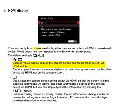

Here is what the menu item suggested provides:
