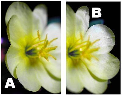

That's what's puzzling to me. I depend on that narrow DOF to set my start point (A), and if I'm using Helicon, to set my end point (B). "A" being the nearest and "B" the farthest. The screen capture example is a dime sized flower using the R5, RF 100mm, and Helicon Remote

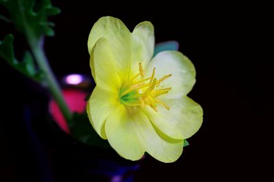

Rendered and color profile added. [EDITED] Oops, I posted the wrong rendering 🙂
The same applies to when I'm using the in camera feature to shoot my stacks. I rely on that narrow f/2.8 at MFD to get a sharp start point. I'm using the same gear as you and have no trouble discerning sharp focus at f/2.8, be it in the EVF, the LCD, or my computer monitor. I looked at your images, and am even more baffled 🤔 My "knee jerk" reaction is that you're either to close, the focus distance switch is improperly set, or your SA ring is at an extreme setting. TBH, I'm at a loss given the success I've had with the RF 100 and the R5 series cameras.
