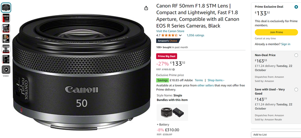

With this lense: Stephen_1-1728401406303.pngStephen_1-1728401406303.png
Is this good enough or?

The body is OK, the kit lens that comes with it, not so good.  The 50mm lens on that body will be too narrow for northern lights I think - on that body, a lens like the RF 16mm f/2.8 would be a better choice specifically for northern lights but will also do a good job for landscapes. Shop Canon Refurbished RF16mm F2.8 STM | Canon U.S.A., Inc.
